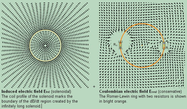

I happen to have ready the pictures with the decomposition of the electric field in the solenoidal and conservative components Eind and Ecoul in and outside a single turn coil with two load resistors on the opposite sides of the magnetic field region (what we can call the Zahn - Romer - Lewin ring [see footnote 5 for references])
the fields Eind and Ecoul in Lewin's ring
fig the Eind and Ecoul fields around the ring
and for the total and component fields Etot, Eind and Ecoul, inside the ring.
field decomposition inside Lewin's ring
The dots inside the first ring represent the negligible (ideally zero) total electric field Etot in the conductor arcs.
The Helmoltz decomosition
This decomposition of the electric field, the Helmoltz decomposition, is mirrored by a decomposition of the actual voltage (computed as work per unit charge) into two partial components. Instead of just passively split the path integral for Etot**.dl** into the two components E+coul*.dl** and Eind*+.dl**,
- path integral Etot.dl = (-path integral Eind.dl) + (-path integral Ecoul.dl)
voltage = induced voltage + scalar potential difference
we can gain some insight by starting from Faraday's law expressed in integral form (remember that Etot is the one and only electric field present in a given point at a given instant of time)
circulation of integral of Etot.dl = - d/dt surface integral of B.dS
and considering that the surface integral that expresses the time derivative of the flux can be turned, by using B = curl A and applying Stoke's theorem, into the path integral of the magnetic vector potential A.
circulation of Etot.dl = - d/dt circulation of A.dl
The right hand side represents the contribution of the induced field Eind. Now, the interesting consequence of this manipulation is that (assuming everything is mechanically stationary so that the contour of integration does not depend on t) if we rearrange the terms in this way
circulation of (Etot- (-dA/dt)) = 0
we now see that the circulation of Etot - (-dA/dt) is zero. This is Ecoul, the component of the actual field that is irrotational and admits a potential function (the electric scalar potential phi). Ecoul can be recovered from the actual electric field Etot by subtracting the term -dA/dt (corresponding to the induced electric field Eind). That double minus sign that becomes a plus sign can lead to the illusion that Ecoul, when written as Ecoul = E + dA/dt is some sort of "resultant" field, but it is not. It is A PART of the one and only total electric field, the electric field any charge experience at time t in the point (x,y,t), i.e. Etot.
We have therefore determined that
Ecoul = - grad phi ---->(partial component)
Eind = - dA/dt ---->(partial component)
Etot = - grad phi - dA/dt ---->(the real deal)
and therefore the actual path-dependent voltage in the complete physical system can be split in a component of path-independent voltage due to the distribution of charges (the scalar potential difference) and a second component of voltage due to the effect of (nearby) changing magnetic fields.
- path integral Etot.dl = - path integral (-grad phi)-dl  - path integral (-dA/dt).dl
Using VBA_gamma for the actual voltage that depends on the path gamma, phi for the electric scalar potential, and rearranging the expression a bit, we arrive at the following decomposition of voltage (the work done per unit charge that considers the complete physical system and obeys Ohm's law):
voltage = scalar potential difference + path integral (dA/dt).dl

The problem with your question is that you state a false premise, i.e. that the loop follows KVL.
KVL and KCL are only valid for lumped circuits, i.e. for circuits made of components (whose dimensions are irrelevant) connected with ideal wires. Step out of these premises and you will start experiencing "weird" contradictions in your reasoning.
The fact is that KVL derives from a more general law, which is part of Maxwell's equations, i.e. Faraday's law (see this).
What Faraday's law states is that a current is induced in a closed loop if the linked magnetic flux changes with time. If the loop is made of non-superconducting wire, it will have some resistance and the integral of the E field along that loop will be non-zero. This means the E field will perform some work to make that current do its merry-go-round.
Since Ohm's law is still valid (microscopically), that work (per unit time) will be equal to the R^2*I power dissipated in the loop. However you can't get a "voltage across two points" that has the same meaning of "voltage across a resistor", since the resistance is not lumped in a single element, but it's distributed along the loop.
Bottom line: there is no terminals across which you could find the induced voltage, as you would expect with KVL. You only have the circulation of E field along the loop.
