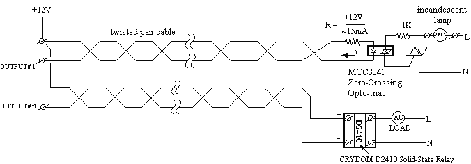

I want to add snubber or supression protection diodes for a solid state relay. Here is the diagram without the diodes:
And this is the SSR I'm going to use: http://uk.rs-online.com/web/p/solid-state-relays/0346895/
What kind of diodes I need and where to place them? The load is a speed controller together with a single phase inductive fan-motor and will not draw more than 1A in steady state.
  • \$\begingroup\$ The datasheet shows a built-in snubber as an option; why do you think you need more? If you get one without a snubber, the equivalent schematic shows clearly where it is placed (values may be interesting to find, though). \$\endgroup\$ May 1, 2016 at 16:04

RS state that that unit has an internal snubber but don't give the full Crydom part number so you can check.
Figure 1. Extract from Crydom Series 1 datasheet.
Contact RS and ask them for the full part number.
  • \$\begingroup\$ Thanks the snubber they show is R C in series not a diode. Why is that? \$\endgroup\$

    \$\begingroup\$ Wikipedia has a good paragraph on RC snubbers. It should give you a good appreciation. \$\endgroup\$

  • \$\begingroup\$ Using diode snubbers with AC power gets... complicated, RC snubbers don't have that problem \$\endgroup\$
