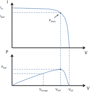

First, you need to know more about your solar panel characteristics. 18V and 280 mA doesn't tell you much, is it open circuit voltage and short circuit current or is it values at maximum operating power (which is likely to be) ?
Usually the datasheet will indicate Voc, Isc, Mpp, V@Mpp and I@Mpp, you can calculate MPP (maximum power point) by multiplying V@Mpp and I@Mpp but not Isc and Voc.
Furthermore, you need to regulate the current you're drawing from the current as a current source, if you draw too much current then your voltage would drop to Zero.
So if your battery bank is charging at 1A and your panel Isc value is 280mA, this means under 1kW/m2 of sunlight you will get 0V, so this isn't going to work.
To charge a Li-Ion battery with a solar panel you either need a battery pack with an oversized panel and some sort of MPPT regulator, or a charger in which you can directly set the drawn current from the source.
What you want is some kind of way to limit the current. There are buck converters which have a potentiometer to do this, which may or may no be sufficient for your purpose, as this is manual labor. If you limit the current, the solar panel voltage will not drop to a unusable level.
If your 18V and 280mA are respectively Voc (open circuit voltage the solar cell can produce) and Isc (short circuit current), then that means the cell can produce 280mA of current at an output voltage of 0V and when no current is being drawn from the cell there would be 18V at the output. In between these points, the Current-Voltage characteristic (general example of a solar cell) looks like this: enter image description here
You cannot use the solar cell on its own in an operating point 'outside' of the curve.
