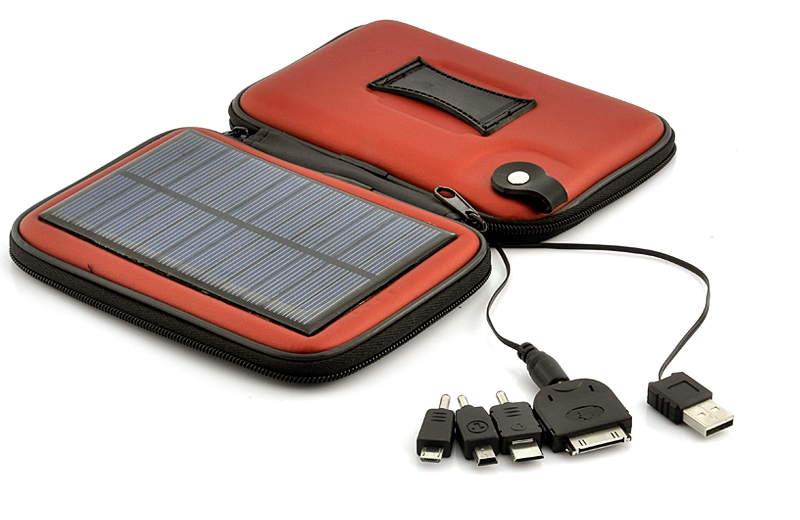

I have an outdoor sensor (which will have to work in the winter on Poland, however, we usually have temperature much over -10 Celsius degrees) which needs 5V.
The sensor operates 24 hours per day and consumes
  • about 300 mA when working, for about 10 seconds every 5 minutes and
  • less than 1 mA the rest of the time.
I want to power it using solar panels.
What solar panels should I use (what voltage)?
Do I need any DC-DC boost converters? step-down? step-up? Could you name some examples? How to look for them?
Are there any ICs for that purpose? For example, does BQ25504 would be helpful here?
What type of rechargeable batteries should I use? Are Ni-MH a good choice?

  • \$\begingroup\$ Since you require 5V, there are 5V lipo modules that have a built in solar panel and usb input, lipo charging and boost to 5V in a under 1" square package. So what you really need to figure out is the battery requirements. Based on 300mA 10 seconds, 1mA 290 seconds, that's an average of 11mA draw. A 300 mAh battery would be sufficient for 24 hours, assuming your solar setup can charge it. Also you need to add in the charging modules current in that calculation. \$\endgroup\$
    – Passerby
    Sep 5, 2016 at 16:38
  • \$\begingroup\$ Easiest solution obrazki.elektroda.pl/5925982800_1473095587.jpeg \$\endgroup\$ Sep 5, 2016 at 17:18
The sensor operates 24 hours per day and consumes about 300 mA when working, for about 10 seconds every 5 minutes and less than 1 mA the rest of the time.
Energy required:
Operate: 10s in 5 mins = 10/300 = 1/30th duty cycle.
Sleep: 1 mA when not operating.
Can be seen as 1 mA continuous + 299 mA x 10/300 = 10.97 ~= 11 mA average
mAh/day = 24 hours x 11 mA = 264 mAh.
Say 250 mAh/day for calculations.
Warsaw in December averages 0.67 sunshine hours per day - Wow! - that's low.
Due to losses from panel to sun alignment, panel to battery matching, battery store & retrieve efficiency and more, storable solar energy is about 50% of the panels nominal maximumcapacity or less.
To get 250 mAh/day you want say 500 mAh + from PV panel.
If you use a 9V panel with linear regulator that's energy of
9V x 500 mAh = 4.5 Watthour per day.
As there is as little as 0.67 hours of average sun panel size needs to be
4.5 wh/0.67 SSH ~= 6.5 Watts.
A 10 Watt PV panel may be "safe".
That is far larger than many would feel was necessary. It may not be.
I said 9V panel out above. I had in mind a 7.4V LiIon battery - 2 series cells. This will charge from 9v. It can use a linear regulator. This is wasteful of PV capacity but more easily implemented than a switching regulator type solution.
In sub zero temperature conditions (snowy) PV panel efficiency will increase slightly over nominal but all batteries will either have much degraged energy output capacity or "just not work". Manufacturer's specification sheets should be consulted and a good idea of minimum temperatures is required.
Lithium based batteries are about as good as any at sub-zero temperatures. Claims vary by manufacturer and model but as a guide LiIon may be rated to -10C and LiFePO4 to -20C.
Battery capacity for 1 day is >= 250 mAh as above. Somewhat higher is "most wise".
If you want operation over N days of no sun you need N x 250 mAh of battery.

Start with a spec for power output and input, budget and complexity requirements so a suitable make/buy choice is easier.
  • 5V & 3V Out, (5v main load)
  • solar PV input
  • _% tolerance
  • 300mA for 10s every 300s or 10mA avg.
  • 1mA standby current or 11mA tot. avg. @5V
  • equiv 55mW avg. power consumption
  • climatic: -10'C to ?
  • low budget prototype ?
  • sustained storage for X days with low solar input for storage energy
  • if X=3 days, storage requirement= 792mAh
  • Consider charge up Time = 10 hrs
  • Consider 2 series LiPo cells (16850) with 6.6 to 7.4V out and PV Voc=9-12V (open cct) with LiPo charger (3 stage) to charge LiPo with USB reg out(5V) that can charge up
  • some options
    • Samsung INR18650-25R $2.43
    • Samsung INR18650-30Q 3000mAh $3.45
    • Sony US18650VTC5 2600mAh $3.58
    • Sony US18650VTC4 2100mAh $2.98
    • LG-HE2 18650 2500mAh $2.58
    • LG-MJ1 18650 3500mAh $3.72
    • LG-HE4 18650 2500mAh $2.68
    • LG-HG2 18650 3000mAh $3.63
    • Panasonic NCR18650B 3400mAh $3.05
If derating capacity to <50% for cold temp and want charge up in 4 hr then PV charge for 1000mAh in 4h = 250mA or a minimum of 20mAh per day average
250mA*9V= 2.25W Choose 3W min. $9 online
e.g. http://www.ebay.com/itm/9V-3W-3Watt-Mini-poly-solar-Panel-small-solar-cell-PV-module-for-DIY-solar-Kits-/251946289450
Increase W rating to reduce charge recovery time.
Buy Option $27 CND or AUD. add USB or DC Jack and 3.3V LDO
http://obrazki.elektroda.pl/5925982800_1473095587.jpeg
