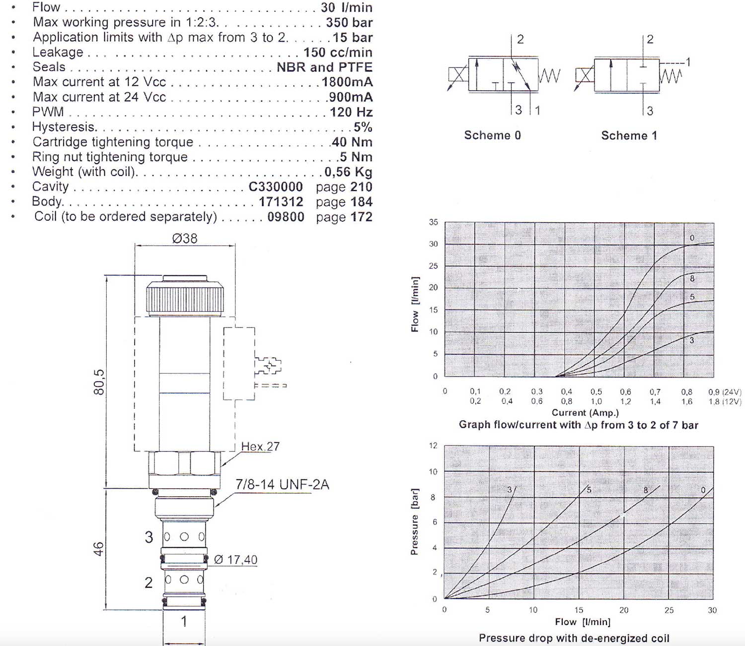

This is the valve datasheet. These are the solenoid details:
V = 12Vcc, R = 3.7 Ohm, I = 1.80A

  2. The datasheet says that the valve should draw 1.8A when powered at 12VDC, but I measured 3A when PWM is 100%. This is very strange!

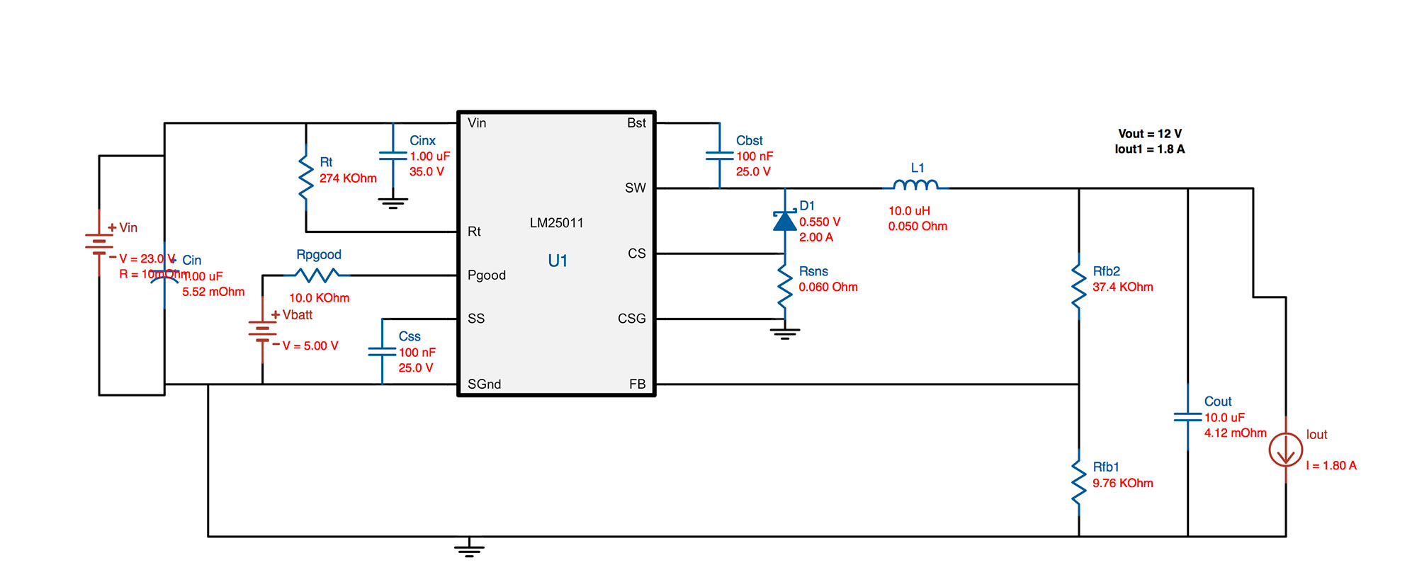

I was thinking to use LM25011 with this schematics. I did this schematics by using the online TI calculator.
Can you tell me if this design could work for my board? I set the Rsense to limit current up to 1.8A at 12VDC.

    \$\begingroup\$ "The datasheet says that the valve should draw 1.8A" No, it doesn't. What it actually says is that you should not allow it to draw more than that. The graphs in the data sheet seem to indicate that the required current for operation depends on fluid pressure. You may need to build a chopping current regulator with a sense resistor - see stepper motor driver circuits to get an idea. \$\endgroup\$ Commented Oct 16, 2016 at 16:29
  • \$\begingroup\$ I forgot to add these details, sorry. These are the solenoid data: V = 12Vcc R = 3.7 Ohm I = 1.80A \$\endgroup\$ Commented Oct 16, 2016 at 16:32

    \$\begingroup\$ No, what you need is not a step sequencing stepper motor driver, but the general type of chopping circuit topology used in one. While it is not a part you would want to use for your project, the "LOAD CURRENT REGULATION" section of the L297 data sheet explains the concept. \$\endgroup\$ Commented Oct 16, 2016 at 20:49
    \$\begingroup\$ The circuit at your link is a linear current regulator, which means that the difference between the maximum power and the power needed will go up as heat in the power transistor, which is basically used as an electronically controlled rheostat. That can be made to work, but a switching regulator is less wasteful, and as a result runs far cooler. \$\endgroup\$ Commented Oct 16, 2016 at 21:09

  • \$\begingroup\$ The solenoid manufacturer said me that it is normal if the valve drains 3A when it is cold. Above 30 degrees, the valves drains about 2A. He said that if I won't limit the current to 2A, I will have different behaviors between cold and warm system. When the valve is cold, the oleodynamics motor will spin faster since the solenoid drains more current.. but i think this is not a problem for me.. \$\endgroup\$ Commented Nov 3, 2016 at 2:46
