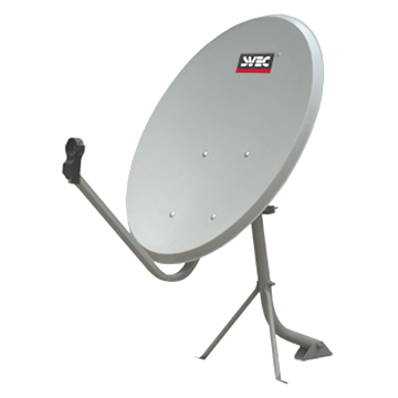

Or this one for a dish antenna: enter image description here

    \$\begingroup\$ The last picture is a the pattern of a dish antenna like asia.ru/images/target/photo/51336884/Satellite_Dish_Antenna.jpg The actual antenna sits on the end of that stick and it sends the waves to the disc, which reflects them in one direction hence the lobe. All waves are guided/reflected to that direction so they add up. \$\endgroup\$ Dec 9, 2016 at 10:05
