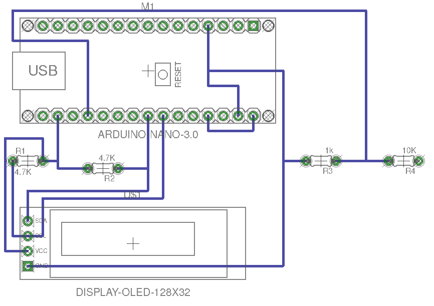

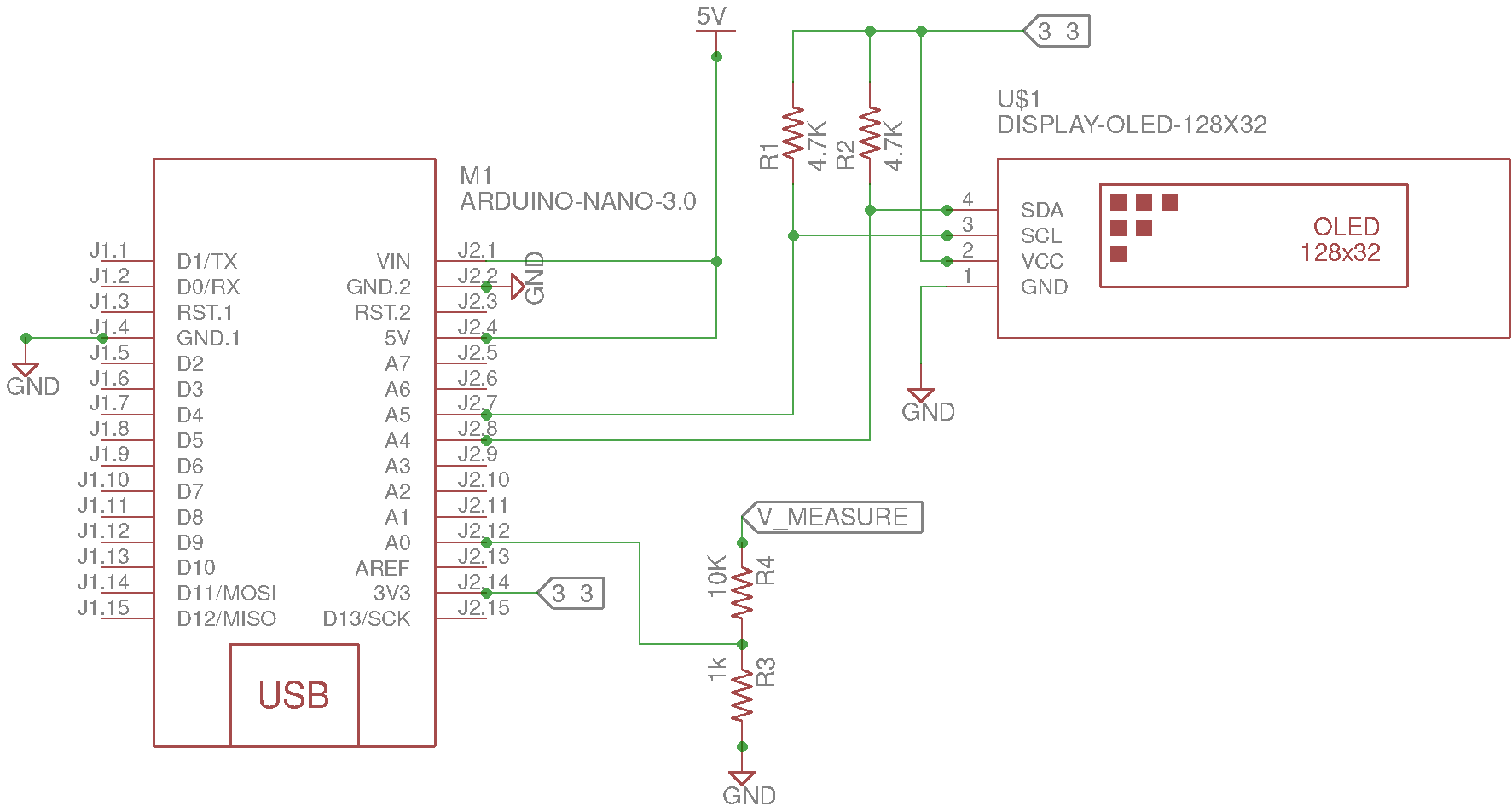

  • \$\begingroup\$ To make sure I understood the 4.7K recommendation correctly I made a schematic in Eagle - does this look OK? \$\endgroup\$
    – ttsiodras
    Nov 19, 2017 at 21:59
  • \$\begingroup\$ Correct. If there are 5 V pullups turned on in your MCU there is a voltage divider effect between 3.3 - 5 V. This means the input may rise above 3.3 V and it uses the protective devices usually present on an input to shunt the signal. It's best to alter your drive library to not pull the SCL/SDA high, then this solution is perfect. \$\endgroup\$ Nov 19, 2017 at 22:53
  • \$\begingroup\$ Great. I did a test on a breadboard and measured with my tiny scope - both SCL and SDA are pulsing between ground and 3.3V when I send the data on the screen. Clearly the u8glib library never pulls high - all good! :-) I proceeded to route for perfboard prototype - thanks, Jack! \$\endgroup\$
