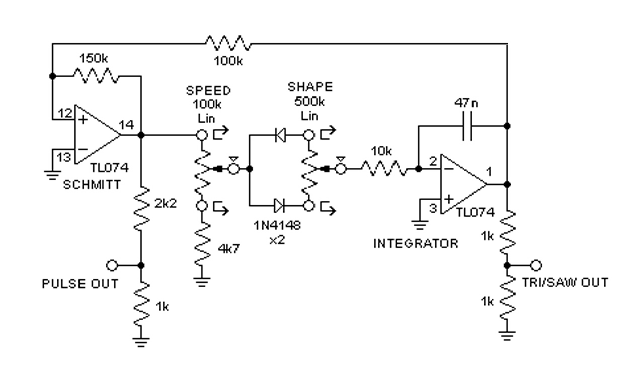

  • \$\begingroup\$ This is the design I'm trying to understand: electro-music.com/forum/phpbb-files/simple_osc2_187.jpg \$\endgroup\$
    – Qrchack
    Dec 7, 2017 at 16:59
  • \$\begingroup\$ Basically I'm working my way from the basics to fully understand what's going on \$\endgroup\$
    – Qrchack
    Dec 7, 2017 at 17:00
  • \$\begingroup\$ The schematic you linked is the op-amp integrator + comparator that I mention above, with two paths to adjust the rise/fall of the triangle wave. \$\endgroup\$ Dec 8, 2017 at 0:25
