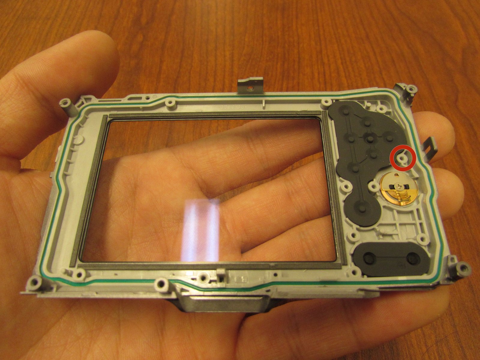

IP67 seal is not easy :) Maybe a silicon keypad with the gasketing built into the part? Then just have to design your enclosure to compress it. Or epoxy it in place.
They make stock ip67 tact switches that are rather large. Most IP rated products are bigger than say the button on an X-box controller.
Again the problem comes down to then sealing that button to your enclosure with o-rings or epoxy. Depends what you're making.
If you really end up having an EMI problem and you used silicon switches you could probably put some flexible emi foam or gasket around it if you had to. That's starting to get fancy though, your all metal case with some small holes in might be fine.

  • \$\begingroup\$ Olympus stylus tough TG-5/Nikon Coolpix W300/Lumix FT5/Canon PowerShot D30 are all waterproof digital cameras with size and style of buttons I'm looking for. \$\endgroup\$
    – D Duck
    Commented Jan 12, 2018 at 22:19
    \$\begingroup\$ Yep and I'd bet they made those as custom parts. Consumer Camera buttons aren't off the shelf although sometimes you will find little tact switches below what looks like a button to the user. So if you have the funds you can do something similar. Make a custom sealable top and use any standard tact switch that you like. \$\endgroup\$ Commented Jan 12, 2018 at 22:46
