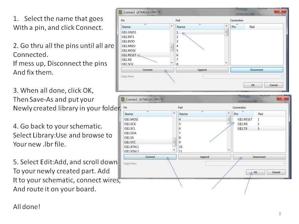

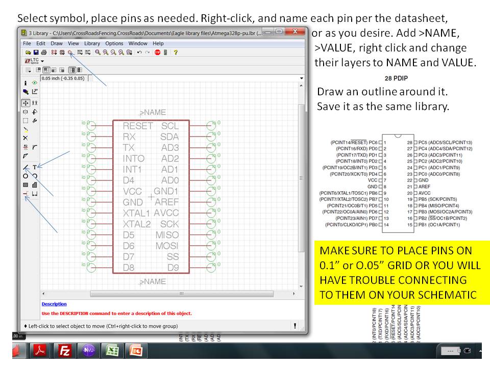

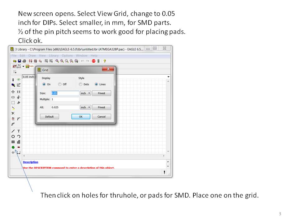

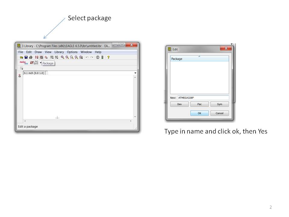

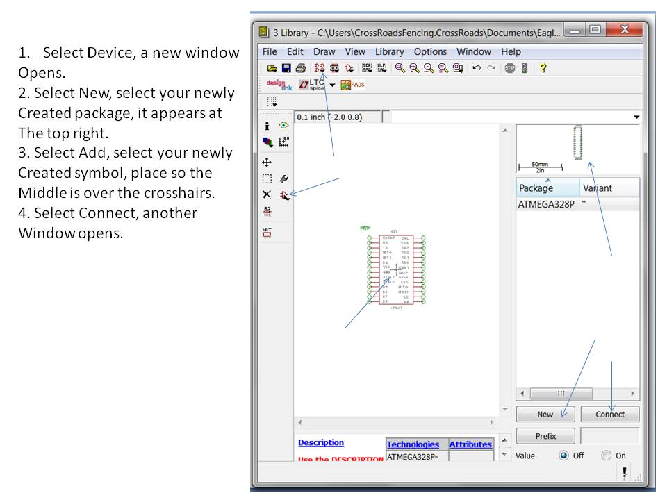

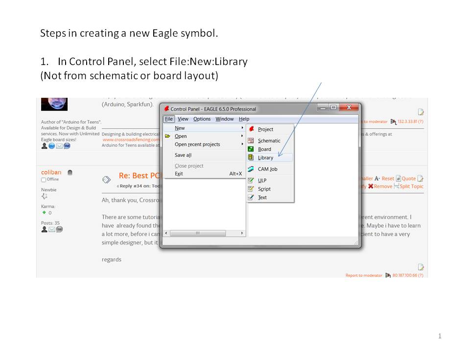

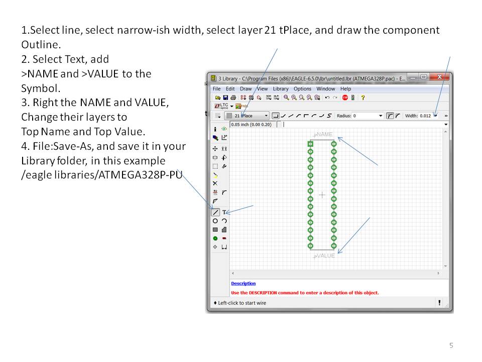

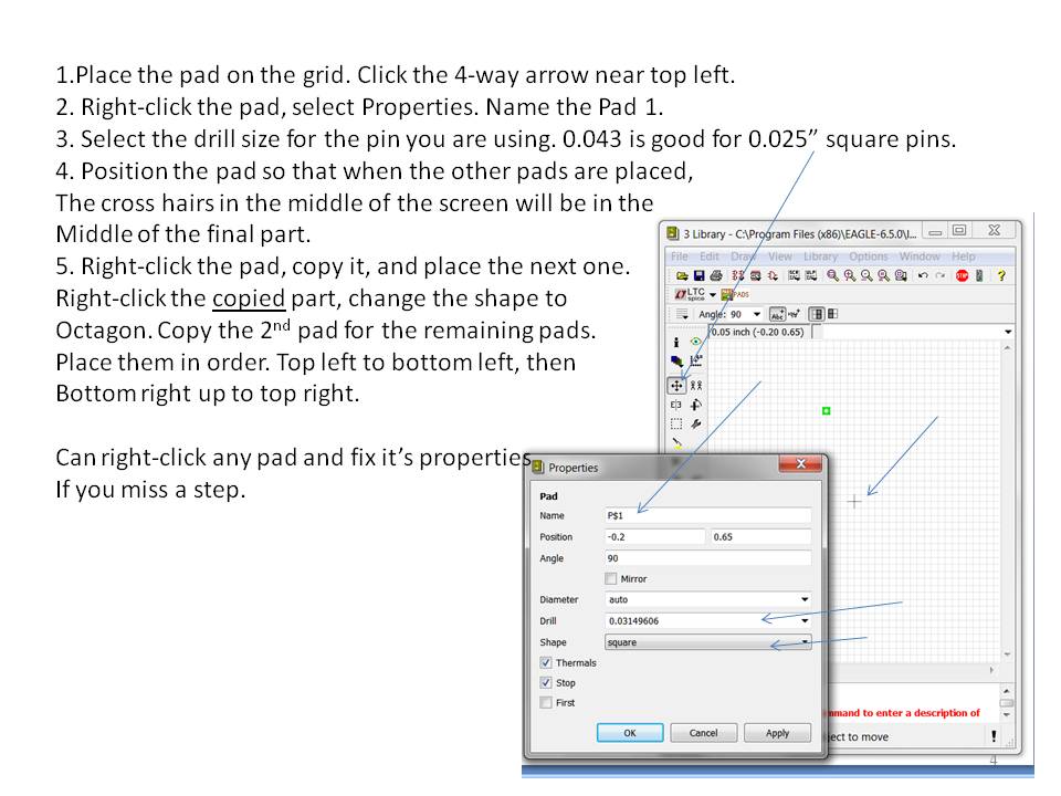

You can make your own schematic symbol & layout footprint in eagle pretty easily, I have a set of slides I created a while ago that outline the process I follow.
http://www.crossroadsfencing.com/BobuinoRev17/eagleSymbol/Slide1.JPG http://www.crossroadsfencing.com/BobuinoRev17/eagleSymbol/Slide2.JPG http://www.crossroadsfencing.com/BobuinoRev17/eagleSymbol/Slide3.JPG http://www.crossroadsfencing.com/BobuinoRev17/eagleSymbol/Slide4.JPG http://www.crossroadsfencing.com/BobuinoRev17/eagleSymbol/Slide5.JPG http://www.crossroadsfencing.com/BobuinoRev17/eagleSymbol/Slide6.JPG http://www.crossroadsfencing.com/BobuinoRev17/eagleSymbol/Slide7.JPG http://www.crossroadsfencing.com/BobuinoRev17/eagleSymbol/Slide8.JPG
