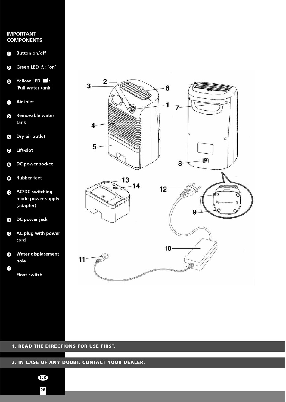

I'm looking for the power adapter for a dehumidifier (Zibro Clima D4) described in the specs as a CE approved 220-240 V, AC/DC 13 V/5 A power adapter, which is shown in the manual and partially shown in this picture.
However, I don't know if the two-pin socket is standard. It looks a little like a polarized IEC C7 connector, but it's square on both pin sides, measuring 14 mm x 8 mm, without the top edge lip, like this:
connector profile
Which search terms do I need to use to find this online?

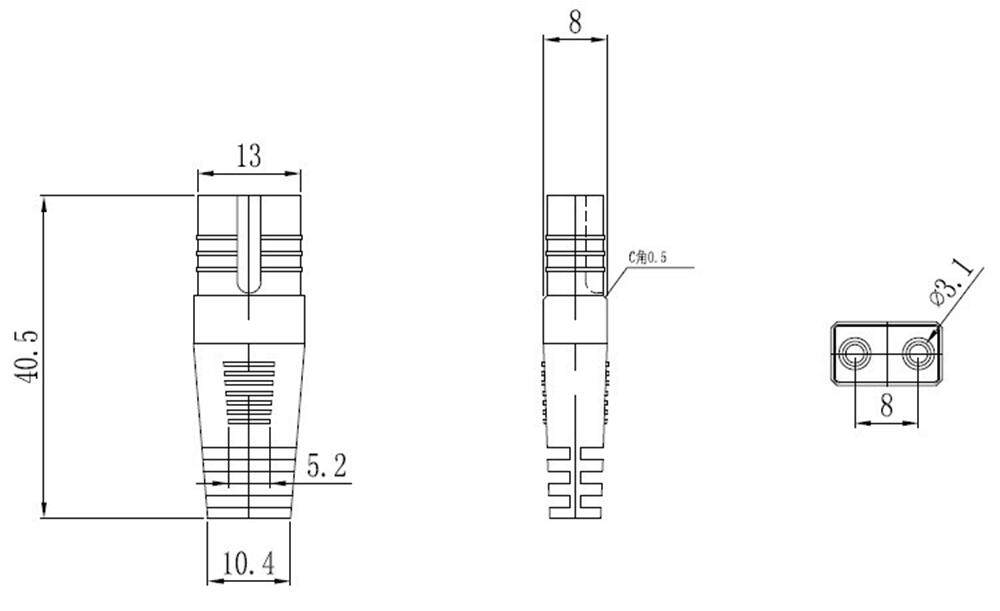

I know this is late, I just started looking for it. It is a R2PPC 2-pin 13.8VDC connector.
A dehumidifier like this is similar to car refrigeration appliances. Searching for "power cord for car refrigerator" leads to results of the correct "B-type plug socket" (a search term suggested by RobertFay). However, searches for "Car C7", "IEC 320 C7" and/or "Type B" in popular search engines did not include the correct socket on my account.
Here is a technical drawing (taken from here).

As someone else has already said, this appears to be an R2PPC plug also used in radio communications. Its also know as a Philmore 8464 plug. I do believe that the Cybernet CB-2 lead for CB radios etc will fit. This plug has rounded corners, but the square cornered sockets should match. The ready made leads may only be rated at 3 amps though. I've seen loose square plugs available on the US ebay site for about $4, but postage and import charges take that cost to $30 to ship out of the US. If it is an IEC C11 plug to match the C12 socket, then the IEC have apparently withdrawn them. There are still C11 plugs moulded onto lengths of cable on Aliexpress.
