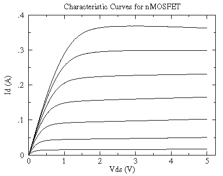

  • \$\begingroup\$ Tony, that graph that you built your answer on, is plainly wrong in that it doesn't properly show the slopes in the linear region and how they vary with VGS. Are you having a bad day because this should be EE101 to you? Try this for size: physics.csbsju.edu/trace/i/nMOSFET.plot.gif \$\endgroup\$

  • \$\begingroup\$ See also this answer \$\endgroup\$
    – Andy aka
    Commented Dec 13, 2019 at 8:39
