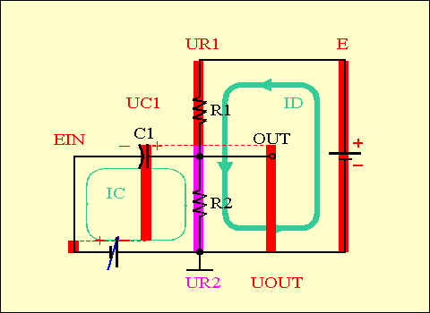

Operation. I have illustrated the operation of the most elementary bias circuit (the input part of the @jonk's circuit) in three steps. They are extracted from a Flash movie (see the animated gif version). The currents are visualized by full closed paths (loops) with proportional thickness (in green) and the voltages - by voltage bars with proportional height (in red). The current directions and voltage polarities are real. The input voltage EIN (VIN) is represented by a variable battery; the power supply is represented by a battery with a constant voltage E (VCC). The capacitance C1 is large enough so the voltage across it does not significantly change when the current flows through it.
1. Zero input voltage. In the beginning, let's set the input voltage VIN to zero. As a result, the capacitor C1 is charged to VR2 (E/2). The charging current flows through the path +E -> R1 -> C1 -> VIN -> -E (not shown in the picture). So the input voltage source should be "galvanic" (with a low DC resistance)... and you can think of it as of a piece of wire. At the end of the transition, there is no current flowing through it since two equal opposing voltages (VC1 = VR2) balance each other; VC1 is a copy of VR2. Theoretically, this process will never finish.

2. Positive input voltage. Now let's change VIN up. The total voltage VIN + VC1 exceeds VR2 (the voltage bars represent it geometrically). EIN and C1 in series act as a composite voltage source that supplies R2 so a discharging current IC begins flowing through the capacitor and R2. VC1 does not change noticeably so the output voltage VOUT follows VIN up.

In the OP's original circuit, the discharging current flows through the path +VIN -> C10 -> R5 -> R12 -> op-amp output -> ground -> -VIN.
3. Negative input voltage. Now let's change VIN down. The total voltage VC1 - VIN is less than VR2; so a charging current IC begins flowing through the capacitor. The charging current flows through the path +E -> R1 -> C1 -> VIN -> -E. As above, VC1 does not change noticeably so the output voltage VOUT follows VIN down.

In the OP's original circuit, the charging current flows through the path +Vcc -> op-amp output -> R12 -> R5 -> C10 -> VIN -> ground -> -Vcc.
Generalization. Let's generalize our observations. With the help of R1 and R2 (voltage divider), an imperfect voltage source (with a significant internal resistance) is built. The perfect input voltage source (with zero internal resistance) is connected through another perfect voltage source (the charged C1) to the imperfect voltage source. In this unequal struggle, the perfect source wins and imposes its voltage on the common output point.
