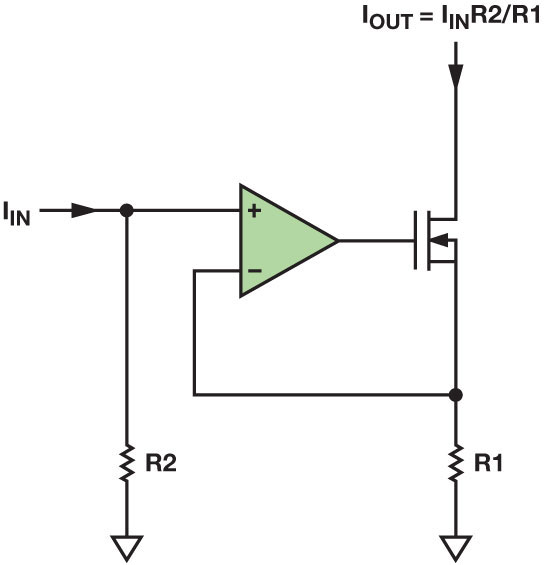

You should try using an op-amp and BJT circuit to adjust the current through the LED: -
Image from here. The LED would connect between the supply and the drain of the MOSFET above. There's also this version that uses a MOSFET: -
Image from here.
You should also be aware that most LEDs will fail if given too much voltage and that controlling the LED current is a more reliable method.
