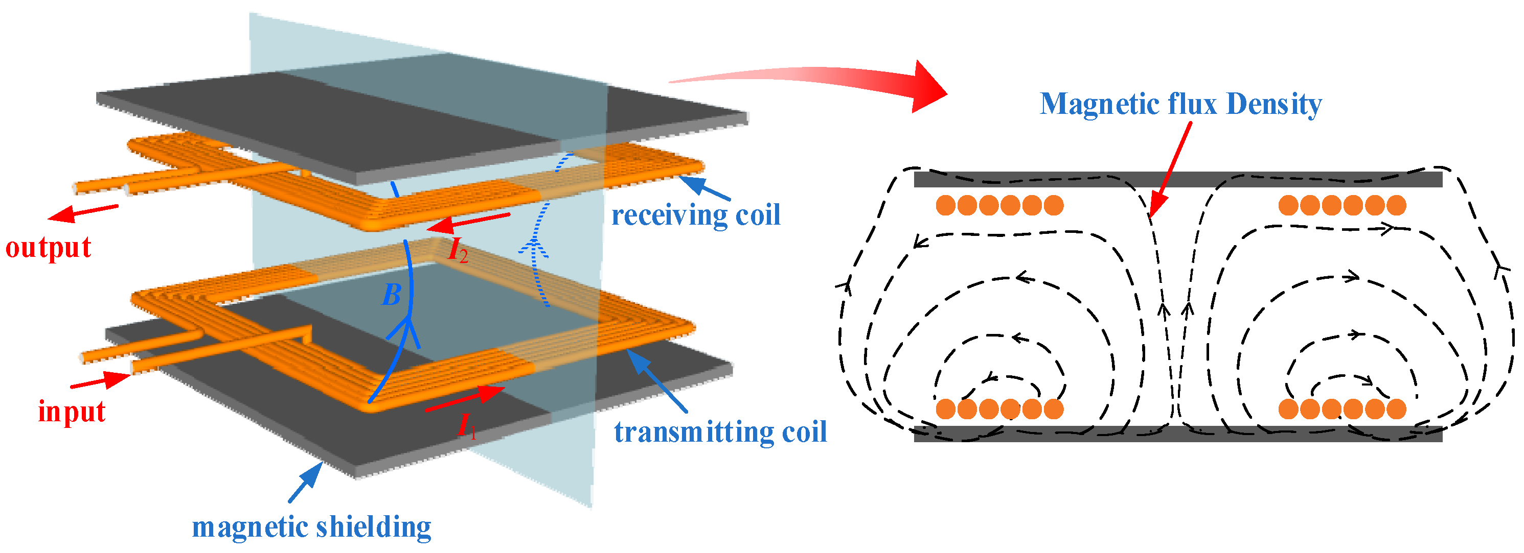

One well-known fact is that putting a ferromagnetic material in an inductor will increase the magnetic flux and thus the inductance value.
Wireless power transfer (WPT) happens through the magnetic near-field. It seems logical that if the magnetic field strength generated by the transmitter is increased so is the field at the receiver. It therefore seems very desirable.
On the other hand all the WPT solutions I have seen use air cores and only a ferromagnetic shield. The high permeability of the shield makes it equivalent to a much thicker air gap, and thus the field at its other end will not be weakened by any metals.
The situation seems to be similar on the receiver side. There are ferrite rod antennas for far-field reception. The connection between two ferrite core coils at a given air gap seems to be the same as if we would take one ferrite rod, wind the two coils on it, and just cut the ferrite rod in the middle and pull it apart a little. The magnetic field should be concentrated in and around the ferrite cores, shouldn't it? Why aren't ferrite cores used in WPT? What are their drawbacks?
PS: an image search has not resulted with any coil using a ferrite core, but the black pad below the planar coil winding is a ferromagnetic material, which concentrates the magnetic flux density. This way the coils can be placed on conductive surfaces, such as the battery of a mobile phone, without great losses.

It is all about the coupling factor between the supply coil and the receiver coil.
A ferrite can funnel the magnetic field through the receiver coil, improving the coupling, but this is not always necessary.
Image a cell phone charger. The phone coil can be very wide - several cm in diameter - and close to the supply coil, maybe only as much as 1 cm away. In this case, even the rapidly dispersing magnetic field of the air coil will essentially pass through the receiving coil with close to 100% efficiency, especially if the supply coil has a similar diameter.
However, if the two coils are further apart the coupling factor rapidly drops for air coils. In this case, field concentration with ferrites can improve the coupling strongly, while the added losses are rather small.

I think they just don't do it because the price for these devices has to be really competitive and that would increase the manufacturing cost.
First, I agree with you, a ferrite piece in the center would increase power transfer. My guess on why the don't have it is more on the economical side. You need the ferrite sheet in order to direct the returning flux and shield the electronics on the other side. A sheet is easy and cheap to make. If now we add a cylinder in the center to direct the power transfer, we have to options:
  1. We design it as part of the ferrite sheet, similar to a planar ER core. Now instead of a cheap sheet, we have a sintered ferrite core, much more expensive.
  2. We design it as a different piece. Now we have to attach that to sheet, increasing the assembly costs, plus the extra piece cost.
Both are bad for business, while not really increasing the value of the product for the average user (non-Engineers), as the charger works fine without that.
